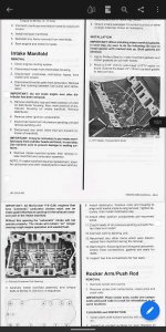

No sealant on the head gaskets.

OK now this is bugging me. For the intake (keep in mind this is the Pre-Vortec) on that Merc manual stuff from Nola Mike it says 40 ft lbs but in my OMC shop manual for the same engine it says 30 ft lbs. Both can't be right!
I torqued mine to 30 ft lbs.
nola mike
Apr 22, 2009
5,962
Gm probably has a third value...
