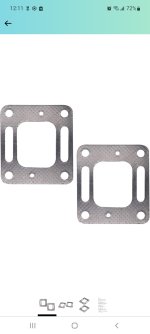

This is what my riser gaskets looked like when I took the risers off. Why would they make them restricted on 2 sides of the water jacket? I am thinking that I will replace them with gaskets that are not restricted.

Your motor should have water hoses to each manifold and each riser. There is a ball and spring device under some of the hoses that helps direct water flow to risers(if I remember correctly). The gaskets were chosen to assist this circulation system.
Use the gaskets recommended for your motor, and use MerCruiser ones. They are thick silver, and are a lot better than the green paper ones. You might lap the manifolds and riser mating surfaces with sandpaper on a piece of glass. It will help them seal better. Leaks at that gasket often let water into the engine.

You are correct, the thermostat housing has a hos going to each manifold and riser and also has the ball and spring thing. So I will order the correct gaskets. Thanks.
