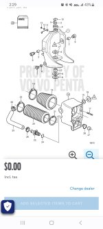

Guys i have a question regarding a broken seal on the TSK SX-M water intake tube. I kept overheating under load and decided to go ahead and replace manifolds and risers due to age. After replacement still overheating under load. I checked impeller which was new and still in good shape. Circ pump is new, hoses from oil cooler to raw water pump is new. I took off the drive DP-SM and found crushed and broken seal around the water intake tube. I gues when the drive was installed it crushed it. Either way i still ordered the pick up tube, o ring, hose and gasket to replace. But i wondered if it could be a possibility of causing the overheat under load. The outdrive pick up tube grommet had been changed a couple of months ago.

Are you referring to the seal for the cooling water intake between the pivot housing and upper gear housing? If this seal is broken, the pump will suck air when the boat is on plane. That could be the cause of your overheat issue.

Yes that is correct. Number 28 on the drawing. I found it crushed and broken. I still replaced it but had that concern regarding overheating under load. I also went ahead and replaced 25, 23, 24 and 27 on diagram.
