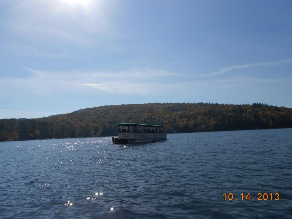

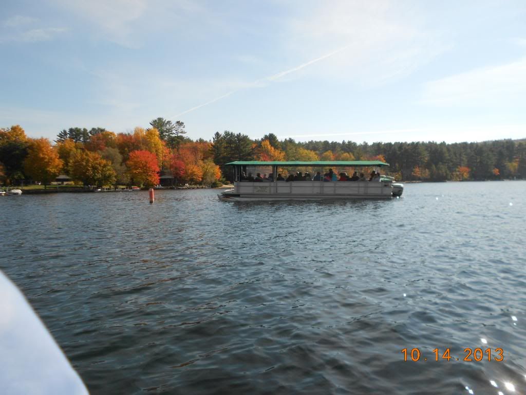

Hi everyone,
On the lake today I saw this from our local boat tour company. I'm far from a pontoon expert, but does this look overloaded to you?
The entire back half of the pontoon was submerged on the left side. :facepalm:

Ha, I have seen that on the local lake tour boat before too.

Probably wouldn't want everyone to move to one side of the boat at the same time...."Oh, look at the pretty duck"..... :)

I would forward those pictures to the local lake patrol and let them deal with it. Looks very dangerous to me.

That looks dangerously overloaded to me. As a commercial operator he has different rules that apply to him but I expect he has not read them. As a private boat, it is long enough that it would not be rated for weight or people.

They have party boat on my chain but never saw one that low in the water. Does not look safe to me.

Thanks everyone. I zoomed in on the pic, found the operator online, and sent them an email linking them to the pics. Part of me thinks I should send the marine patrol, but we'll see what they say first.

Only a guess. I would have no problem with this situation. I can only assume the captain has sufficient PFD's onboard. Personally, this doesn't scare me. Sending the pic to the operator is a good idea. Going to see the boat yourself is another good one. Calling the authorities at this time maybe jumping the gun. If I called them every time I saw a dangerous situation around here, I wouldn't enjoy my day. I appreciate your concerns, Tom.

not saying it is right, but each person has a chair... very likely there is a life jacket under each chair. Again, not saying it is right, but that boat is well above 26 ft long (aka, no capacity plate), and presumably the operator has a commercial license.

I have been out on some boat tours.....some on the Wisconsin River, some on Lake Michigan. Everyone has a metal folding chair.....the life vests are all stored in a giant holding area. If you have ever gone on one of these types of tours, you know they take detailed counts of the number of people they load on......I would guess they have more than enough life vests for what they knowingly take. It does look low....maybe there is a problem with the boat and not the # of people

I got a nice reply from them yesterday:
Boat Tour Rep said:
Hi Tom:
Thank you so much for taking the time to send us the photo and I agree the boat does look lower in the water than it normally does with a full load of people. We have recently lowered our passenger capacity numbers on our cruises based on the new 2012 coast guard “assumed average weight per person” standard of 185 as compared to the weight the boat is certified to handle. It looks to me as if they had some heavier folks on there that day, it always rides a little low in the rear but you usually can see the top of the pontoon so I see what you mean. I have a boat on Squam as well and I see the tour boats all the time in motion and I have never seen what you witnessed. We revisit this issue yearly so your photo will be a great help in planning for next year and I think it may be time to back off the numbers even more. I even went down to the dock this morning to look at the boat empty to make sure that she was not listing due to a breached pontoon which might have water in it, that has been confirmed to not be the case.
Our lake cruise season ends this week and this is perfect timing to get this information as we plan for the next season so thanks again for your time Tom.
Please let me know if you have any further questions, have a great winter!
It's great to see them take this kind of thing seriously. :)

I got to thinking ... some of the being low in the stern may be from trimming the engine up while underway to prevent the bow from diving... it might just level out at rest
