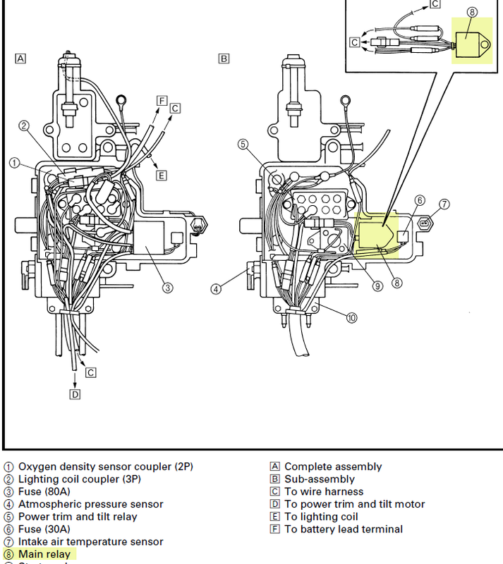

Bought a main relay to replace the one on my ox66. I have the electrical diagram, but I'm not sure exactly where it is located and what has to be removed to get to it.
Any Yammy experts out there who can walk a rookie through an install? I am not a mechanic by any stretch, but I am capable of following directions. It's a 2003 sx200txrb.

Why in the world did you buy a new relay without having confirmed that the existing one is defective?
It's on the right hand side of the motor. Under a black plastic cover.

Been doing a lot of research. Fuel pump intermittently stops working. When it shuts down, no voltage to it. After a few minutes it will fire back up. From everything I have read it sounds like the relay overheats, shuts down, and recycles when it cools. Found a used one for $55 bucks so I thought it was worth the risk to replace it. Hope it solves the problem. And thanks for the info.
