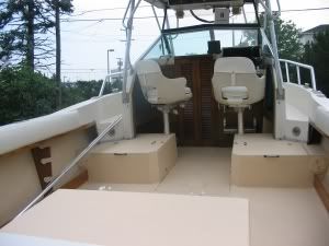

I am considering painting the floor of my Grady like this one.<br /><br />Kinda like the way it looks........<br />Current condition of the floor is less than perfect.....not soft, but doesn't look so hot.<br /><br />Any suggestions?<br /><br />

Go with an epoxy paint. I used a two part Interlux on the deck of my boat and it's still holding up 8 years later. It's expensive but worth it. Make sure you add some non-skid compound.

Any hints on preperation?<br />Can it be "rolled-on"?<br /><br />The deck is already "non-skid".<br />Will the paint "fill-in" the built-in non-skid?<br />Is that the reason for ading this material?

Interlux provides good intructions. They even use to supply a tape with the paint.<br /> <br />Like any job worth doing, prep is 90% of the job.<br />You first sand the deck and then fill in any voids with Marinetex. You might have to use bronze wool on the existing molded non-skid instead of sand paper.<br /><br />Then you'll have to put a coat of epoxy primer down. Then at least two coats of the epoxy.<br />It's very easy to apply on horizontal surfaces by using those narrow diameter foam rollers.<br />On vertical surfaces use thin coats finishing by tipping with a brush. The directions explain this.<br /><br />I'm not sure what it might do to your existing molded non-skid.<br />Put down the primer and the first coat and then see what you have. You might not have to add any non-skid compound. <br />Remember that Grady's are not white in color.<br />You'll want to go with an off-white.
