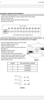

Ford 302. Pertronix igniter 2. Billet dizzy for the 302. Plug and play so they say. Issue is it came with silver springs. Here is a pic of the different curves. I'm thinking it should have black. I dunno

Yes the copper would start the advance earlier in the rpm range. Also need to check total advance but I assume that is limited the same regardless of what spring is used to change how fast it comes in. You can try it but also pay attention to total advance to make sure it does exceed the factory total or what ever your engine builder may have given you. At first glance being all in at 2000 rpm seems early , again not sure what the engine should have. You can always try and see but keep an ear out for detonation.
It wouldn't explain different performance once it is good and hot. Would think that is a temp or carburation issue, basically not running well cold ...
