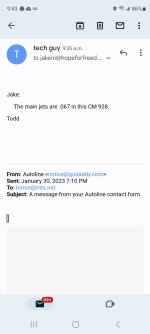

I'm using the matching coil to this dizzy. Here's a pic from autoline about jets

The pressure is good. I just pulled my jets out and they have no number of course. Autoline did tell me .67 so hopefully that's what they are. Anyways I will get .68.69and .70
You can measure them with a pin drill - a 67 should be dia of .067"

I went to a carb shop and he doesn't sell parts. However he measured mine wich were 70. He happened to have a set of 77 and gave them to me. Shall I throw them in and see what happens

It was autoline who said .67 the carb guy slid a peice of brass in and then used caliper and suggested it was .70

Yeah by carb shop i meant autoline. So bottom line they dont know what parts they are putting in their rebuilds …which is the knock on big carb rebuilders
