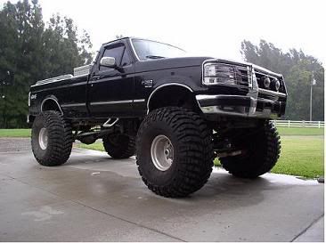

If you insist on using that trailer, just get one of these.....
