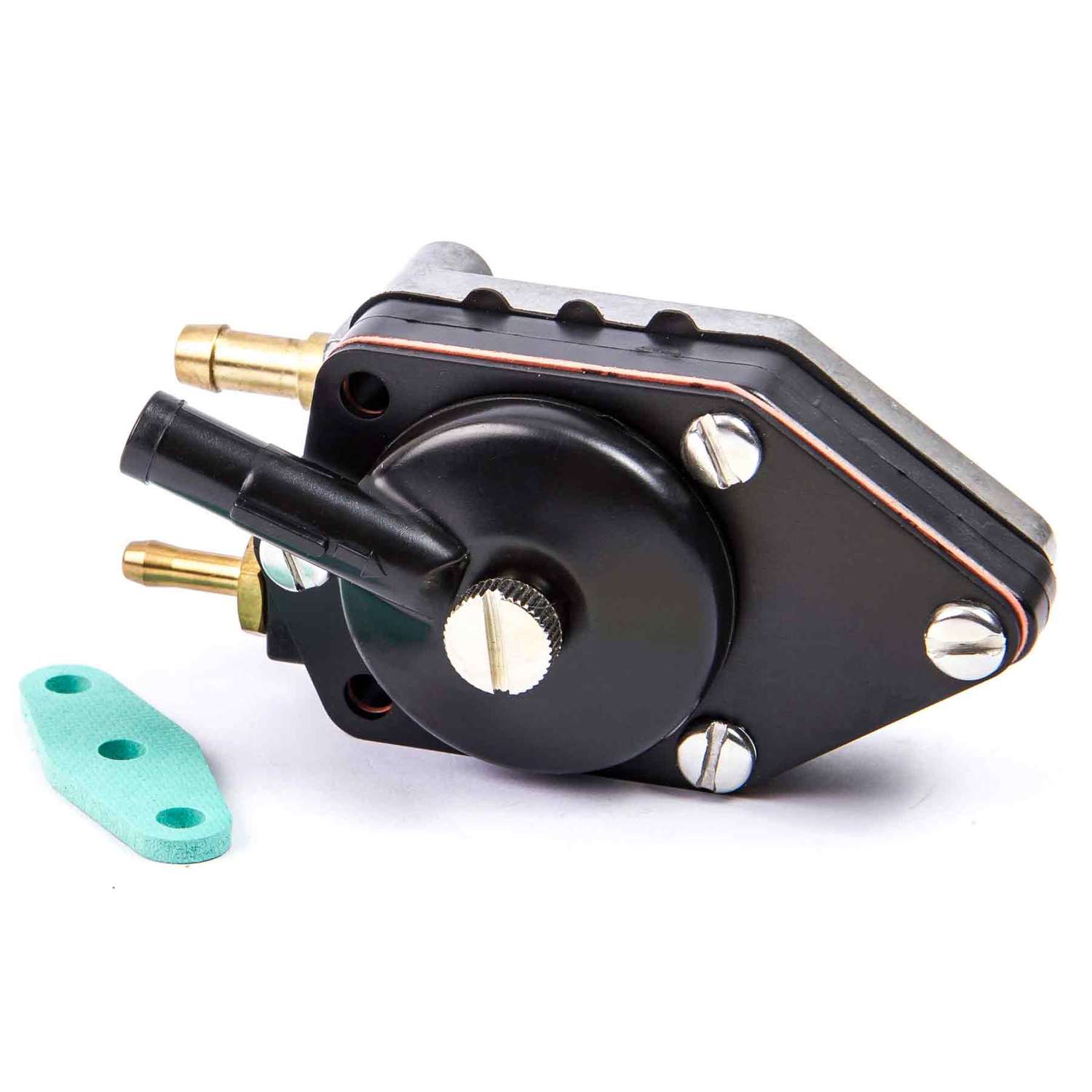

Even though fuel pump is new, have you tested pressure and flow ?? Have you tried l mount the primer ball when it stutters ?? Just some thoughts...

Fuel Pump I'm still suspecting as the most likely cause since the fuel lines seems to be lined up properly.
The fuel pump does have fuel flowing through it. I have those clear fuel lines and can see gas getting where it needs to go. It will pump up good and hold firm for a strong start. Bulb then get a little weak. Ill squeeze the bulb and pump and motor will run stronger. If I keep pumping on the bulb it eventually will just quit running at idle either way. Bulb never really collapses like I've had bad fuel pumps do in the past. If bulb is 100% full and firm before i start motor... Id say only looses 10%-15% of its fuel capacity. Nothing very large. (i know this might not make sense, and its hard to explain).
My tank and bulb are both Moeller and the same ones i run all of my motors through. Fuel is 50:1 and mixed up well. My gas is a blue color. I ran the same tank and bulb on my mom's 15 hp motor when i went fishing for an entire day 2-3 weeks ago, so i have a hard time thinking my tank/hose/bulb are bad.
