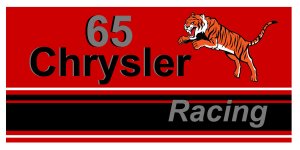

I just finished the painting of the lower leg and ran into some trouble with the clear coat. It turned all milky on the silver part. Luckily it cleared up for the most part, still have 2 or 3 spot on one side, I hope they are gone tomorrow. If not it's ok. The picture shows the clouding at it's worst, it's much better now.
The paint I used where actually the cheapest I could get my hands on and if it doesn't work out, well then there's always another time.... Maybe.
And besides lately I have actually found some of the cheaper cans to be better, go figure!
I also played a little with the motor cowl design in Photoshop, take a look and tell me if it looks stupid! It probably won't be exactly like that, but it's an idea.

Nordin
Jun 12, 2010
2,715
Nice work, looks great.
Is the decals from the factory brochure 1979 model?
I think I have seen the tiger in that year, but can be wrong.
Looks really nice.
las
Sep 22, 2014
165
Thanks, no the tiger is just something I found online available as a decal. But the inspiration is from the 70' Chrysler brochures were they use different tigers in their brochures.
I wanted something not to detailed with a simple line to it, and with some colors to give the whole thing some life.
I've just send a request to an ebay shop if they can make the decal 15cm and with a left and right one for me. I would like the tiger to jump towards the same side on both sides of the engine.
The rest is just some lettering , colors and lines I put together in photoshop.
