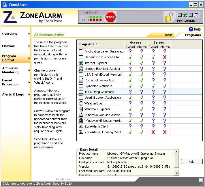

Plainsman
Apr 2, 2006
4,062
Re: Ping flooded while downloading...
I just downloaded ZA free application and you can block ping with it.
In ZA go to program control>programs>click add and go to C:\WINDOWS\system32 and look for ping.exe once added you can click on it in the programs area of ZA and block it.
