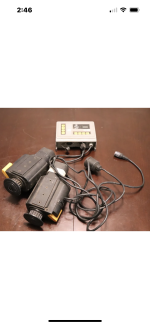

Upon further review I see the second plug port is a 7 pin as well as the motor except the pin on the motor is inline with the tab and the pins on the unit are between the pins so definitely a connection for the other two forms of guidance like the DGPS antenna that was in the box. Antenna has a coaxial cable with no end on it. It does have the end that connects to the antenna.
Here is what I have plus the antenna is just out of the picture to the left
