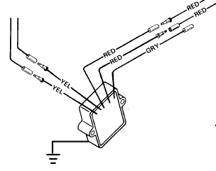

Ive looked for days, beginning to think it doesnt exist, if there is one please point me the way , its the one with the 2 wire reg/rect. Thank you f
What does yhe grey wire go to? Mine only has 1 red not 2 and mine has 1 either grey or brown or tan color. The only wires that match up is 2 yellows and 1 red that leave the reg with 1 black I assume that bolts to motor and a grey wire and a red wire for nothing hooked to and on motorside 1 light clored wire.. that includes Not using 2 wires from old reg and not using old rect
6 wires dont equal 4...so if it dont get easier im screwedWhat does yhe grey wire go to? Mine only has 1 red not 2 and mine has 1 either grey or brown or tan color. The only wires that match up is 2 yellows and 1 red that leave the reg with 1 black I assume that bolts to motor and a grey wire and a red wire for nothing hooked to and on motorside 1 light clored wire.. that includes Not using 2 wires from old reg and not using old rect
The tachometer.What does yhe grey wire go to? Mine only has 1 red not 2 and mine has 1 either grey or brown or tan color. The only wires that match up is 2 yellows and 1 red that leave the reg with 1 black I assume that bolts to motor and a grey wire and a red wire for nothing hooked to and on motorside 1 light clored wire.. that includes Not using 2 wires from old reg and not using old rect
I wired it yellow to yellow and yellow to yellow and 2 reds to 1 red and grey to the lighter colored one i assume its grey and blck to ground... Whats confusing me is on the diagram it shows 2 yellows to gboth reds (all reds either come from or go to battery positive no mater they're origin).. make up to any motor red .. one yellow to one motor yellow, repeat with other two.. gray (there is no tan or brown) makes up on motor gray (tach signal wire).. black ground
I giv up stick a fork in me im done, not looking to fix anymore, am looking for some dynamite bout now.I wired it yellow to yellow and yellow to yellow and 2 reds to 1 red and grey to the lighter colored one i assume its grey and blck to ground... Whats confusing me is on the diagram it shows 2 yellows to g
that should work.. don't understand why it would show any yellow ta ground.. on all mercs tha only color goin' ta ground is gonna be black or black/yellow tracer (kill circuit)..........................I wired it yellow to yellow and yellow to yellow and 2 reds to 1 red and grey to the lighter colored one i assume its grey and blck to ground... Whats confusing me is on the diagram it shows 2 yellows to g
Stick a fork in me, im done, i am now trying to find some dynamitethat should work.. don't understand why it would show any yellow ta ground.. on all mercs tha only color goin' ta ground is gonna be black or black/yellow tracer (kill circuit)..........................
