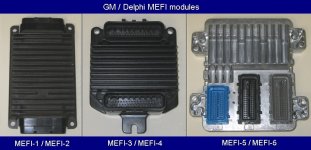

GSI could be
PBYDCE MEFI-1
PWTR MEFI-3
round old style distributor cap.
two plugs out the back of the distributor (Large and small)
EST ignition
To set timing place a jumper across the DLC connector at pins A and B to put motor in base timing mode. Then adjust timing

I must admit i dont know what
PBYDCE MEFI-1
PWTR MEFI-3
EST ignition means or how to tell them apart
I will look for that connector but from what i remember there are two larger ones maybe I will look at those.
would you know the RPM and timing mark to use?
also the temperature gage isnt working so I will change the temp sensor if i can find it (any ideas) there is a sensor at the thermostadt housing I suspect that is it.

These are the connectors that I have but I can’t find the DLC connector to jump pins A and B. I can’t seem to find anything on the Internet how to time this engine

alldodge
Mar 8, 2009
44,436
This is a Merc but your connector will look similar. Connector has a cap cover on it in pic that is removed to use. It ight be near the front of motor around thermostat
I found it thank you! it was tucked away and hidden! I set the timing and it ran pretty good not perfect but much better! I think my issue might be I am one tooth off on the distributor but the movement of the distributor has enough movement t o make up for it mostly, so I will double check that tomorrow and re time it! thank you for you help!
