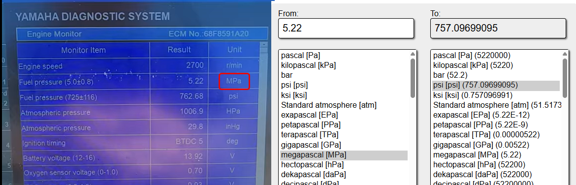

Can you post a screen shot of where you are seeing 4.8 psi in YDIS?

Hooked up to YDS and verified no codes, low pressure was at 4.8psi and high pressure was bouncing from 675 to 720. Ran the rpms up to 2800 and everything seemed stable until about 30 seconds when fuel pressure starting dropping on both the low side and high side and it shut off. I couldn't tell which pressure dropped first.
That is not a low pressure pump value. That is the high pressure pump value just expressed in a different unit of measure.
