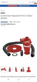

I ran across this as a possibility, I remember years ago redoing my house that there was a wet dust collector I had with a 5 gallon bucket. The dust went into the bucket and not the vacuum albeit I burned up shop vacs because of how much I used it.
I don't see it for sale but there are videos on how to make your own.
Is it worth the trouble I don't know but just a thought 😊
This pic I am posting is different but cheap at harbor freight.
I never thought about it during my project 🤔
I just made one using the 5gal bucket, this morning, plan on putting it through the rigger this weekend.
I’ll let you know how it works out

I've used versions of those extensively in my work. There are examples and instructions for how to build simple ones online, and they work quite well.
Have one permanently hooked to one of my chop saws that catches most of the dust before filling the shop vac bag.

If you can afford it, buying a Dust Deputy was one of the best tool investments I made when doing my restoration. I also bought a 13 ft hose for my vacuum and a remote control outlet so that the vacuum and dust deputy could be on the ground outside the boat, and you can still turn the vacuum on and off without having to climb out of the boat.

Seems to work pretty good, I already had dust and debris in the bag, so couldn’t judge how much was going into the shop vac.
I was grinding for about 45 min, with this ending up in the 5 gallon bucket. I only had the hose near were I was working, still plenty of dust in the boat that ill vacuum up later
Ok, break is over, back to it😄
