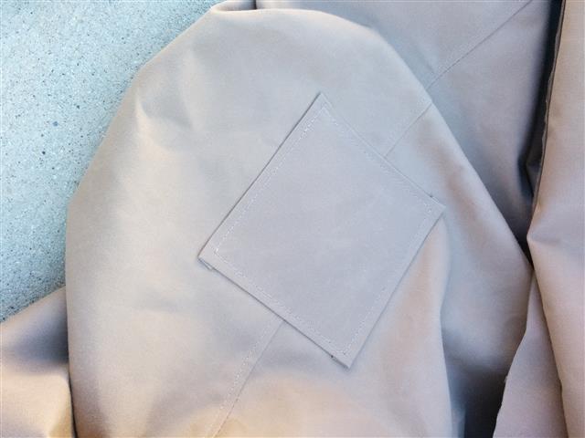

These are installed pretty easily with no special tools, even act as a small vent. 3 or 4 should be all you need.
https://www.walmart.com/ip/Taylor-Bo...&wl13=&veh=sem
I use those too on my pontoon boat cover I made. It's best to add some reinforcement in the area though as your cover will rip over time where the hole is put in it.
