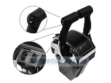

The Shift Control is a QuickSilver Link below (same but Older)
http://www.marineengine.com/parts/images/mercury/883711A04.jpg
The Port Side Shifter wants to go back to neutral at low RPM.
I must keep my hand on it until I reach half way (50% travel). At that position and 100% Travel it will stay
in position.
I have no problem with the Starboard Shifter.
Both Shifters will engage OK, Forword & Backword. Neutral Position is OK for Both also.
Is there a Tension adjustment on the Remote Control Port Side Shifter?

Yeah there should be a tension screw under the cover or down lower.

After you take the cover off, you will have to remove the 4 screws holding the unit into the dash or possibly from under the dash to get to the friction adjustment. It's below the handle an inch or so.
