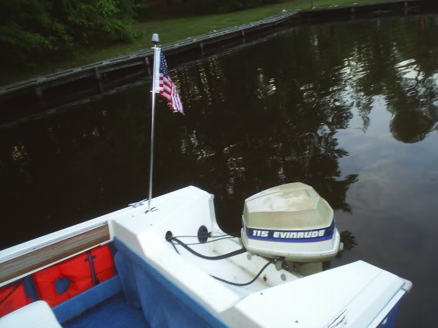

I have done some looking, but does anyone have a link to transom replacement on a boat like this? I would like to find out if the transom can be replaced without taking the cap off?
jbcurt00
Oct 25, 2011
25,328
Re: Potential for complete loss?
Only way to get the transom replaced on an outboard boat is cap removal. I wouldn't want to have to make cosmetic repairs after cutting the boat splashwell off, but you could just cut it off, and only have a small portion of the cap removed:
Pick somewhere w/ lots of FLAT area & no inside outside corners. W/ a wooden backer, & new fiberglass laid over the cut, IMO, flat areas would be much easier to fair & make look 'right'. Don't forget, you'll be grinding a taper back 6-8" from the cut surfaces, so try to keep that in mind when you look for a place to make the cut.

Does your splashwell look like this...
