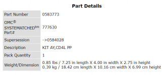

I have a Johnson GT100, model J100STLCEM. I just orded a power pack, part #584028, which has not arrived yet. I started to take the old one off the motor and saw the part number printed on it is 583773. Not sure how I bought the wrong one but some websites list both part number under the description while others list them and different parts. Any idea if they are comparable? Thanks

They are not different manufacturers. 583773 is NLA and has been superseded by 584028. So you are getting the correct part #.
