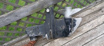

This is the only photo I have right now.Will take a closer look at it.Charlie

I have available to me a pre alpha drive off of a v8. I like the idea of having a spare drive .Im running twin Alpha drives 1988 Mercruiser 5.0 XL .Can this pre alpha drive work for me as a spare?? Or can the upper or lower be interchanged with my alpha ?? BTW it would be strictly for emergency use.Been there before.Charlie
Ayuh,...... It Should work just fine for ya Charlie,.....
It should swap, as a complete drive, or just the upper, or just the lower,.....
nola mike
Apr 22, 2009
5,853
Although as ½ of a twin engine setup might be a bit wonky. That drive sure looks like it's been driven hard and put away wet
