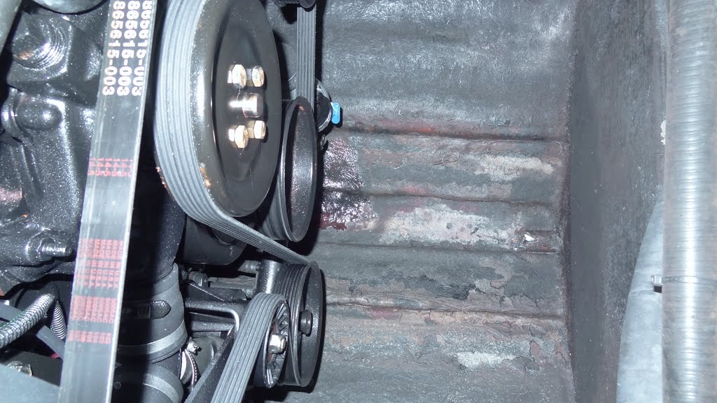

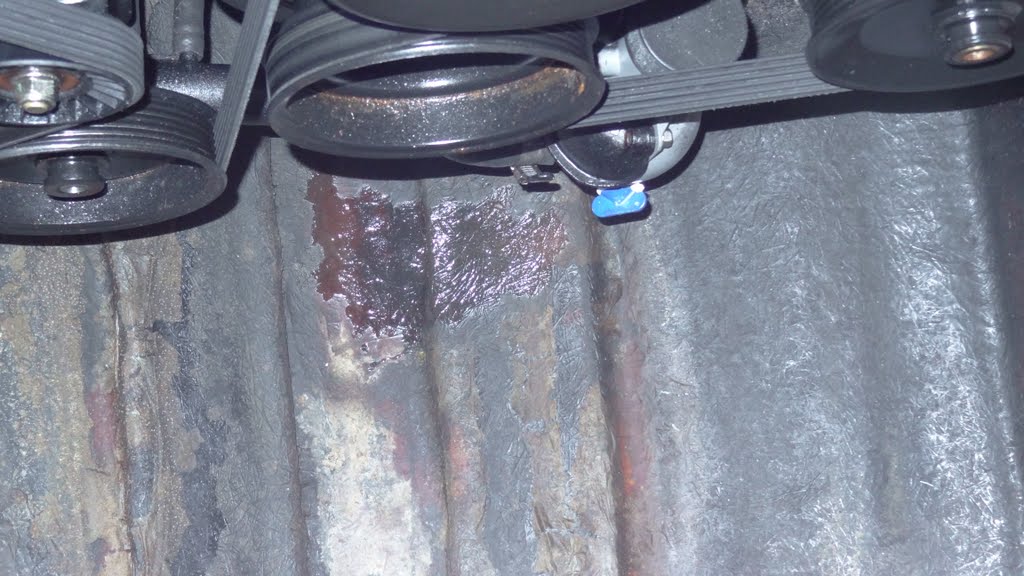

The below appeared to be new oil and I couldn't find the source on any of the hoses by feeling around anything I could reach. I put my foot in it when standing and felt the oil with my fingers and it felt like new oil, so I'm assuming it's a spill when filling the but wanted the forum's advice.

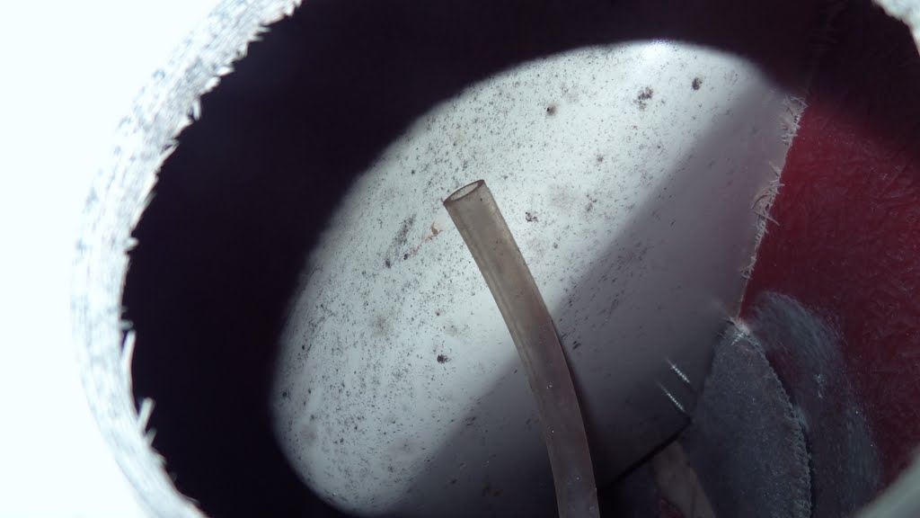

Also, looking at the fiberglass above the tube on the floor, the fiberglass bulkhead that's parallel to the transom gets darker as you go lower, but felt solid when tapped. Same sound above and below. What might account for the color change. Just dirt/grime?

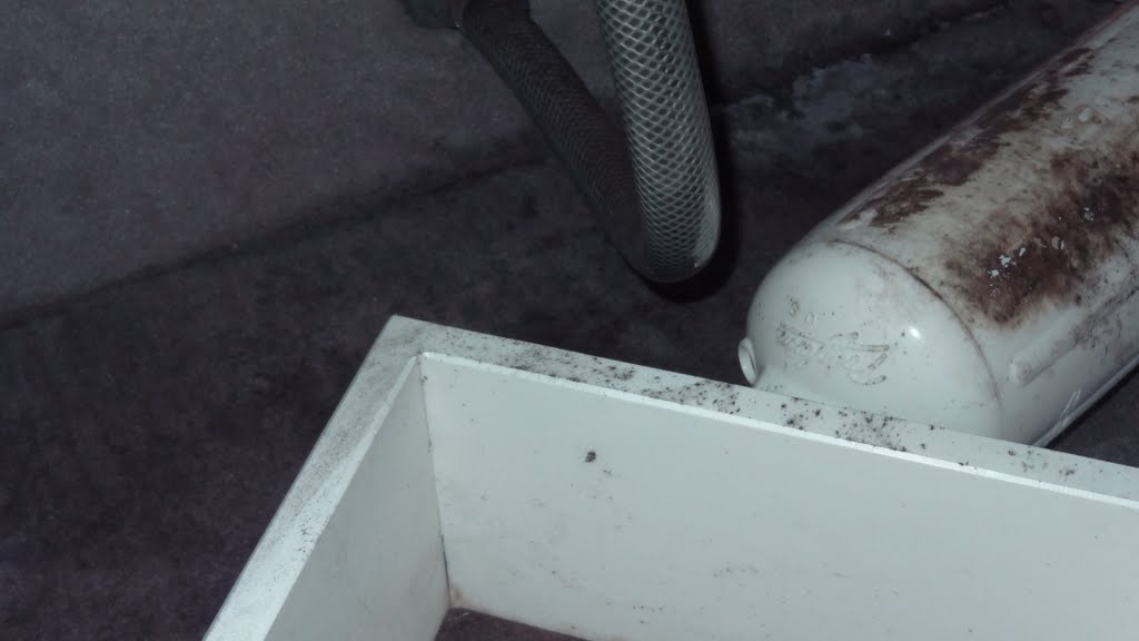

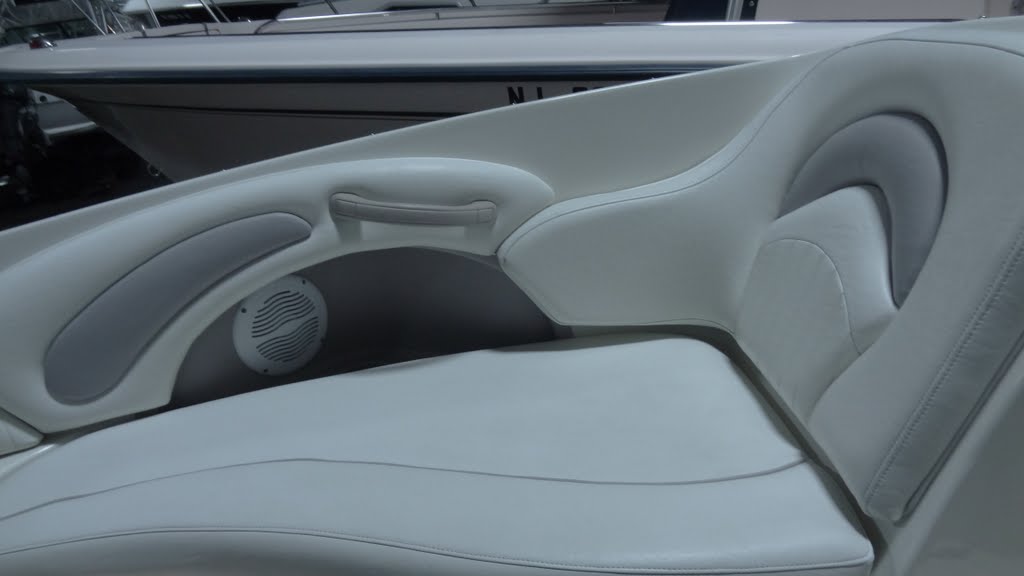

Below is an example of the mildew/mold.. This example was from under a cup holder.. The loose tube is from the cupholder and was reattached.

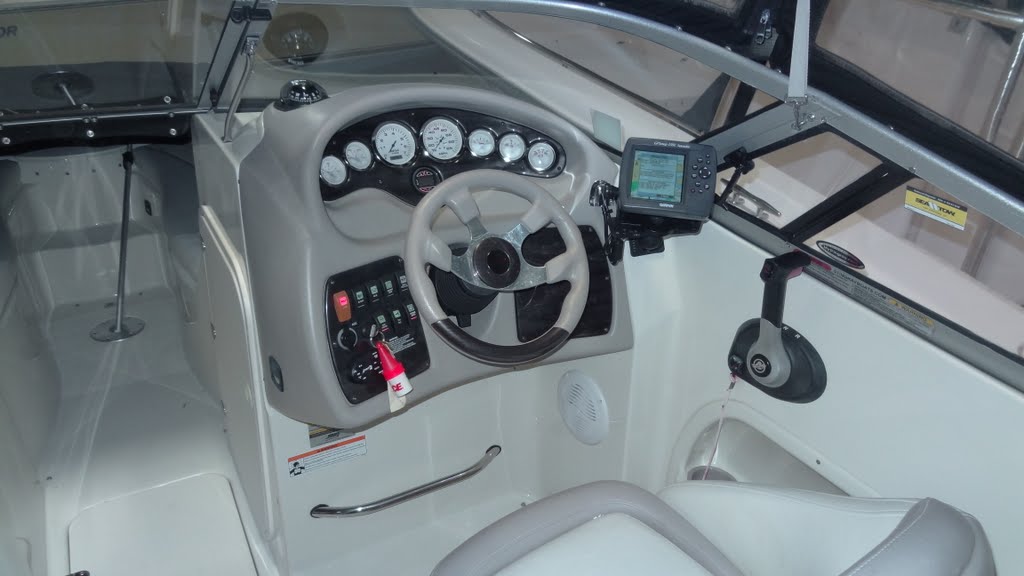

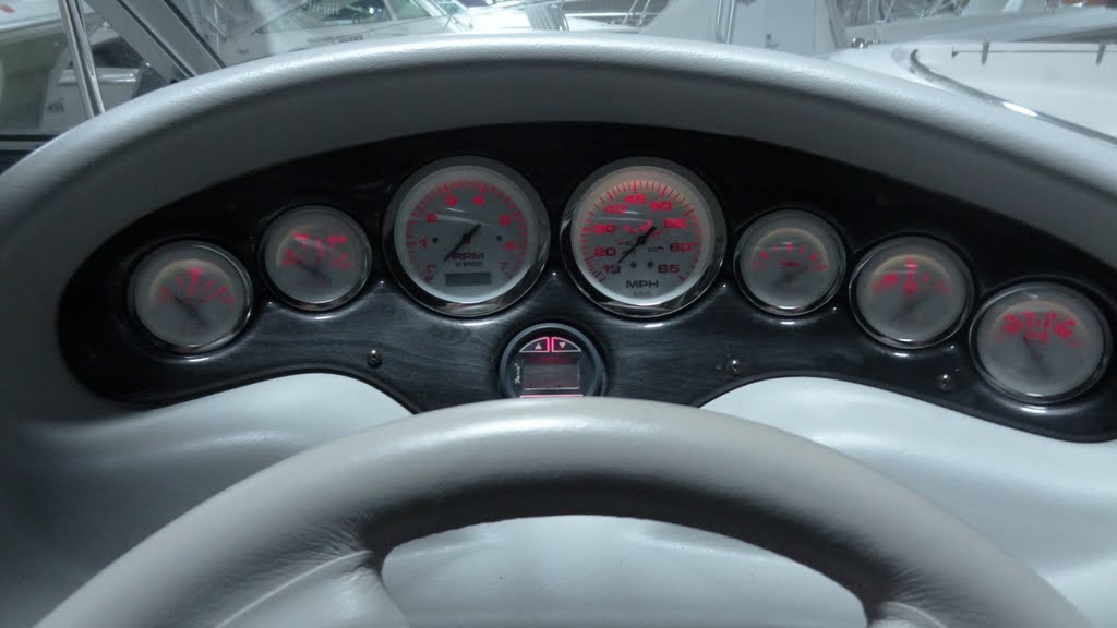

The foggy instruments. The storage in front of the helm had wet lifejackets, which I suspect caused the moisture. Does this just need a good drying out or is this a bad sign?
Example of the mildew. Several closed compartments had wet life jackets, fenders and ropes that I suspect caused this. What do you think, minor or major issue?

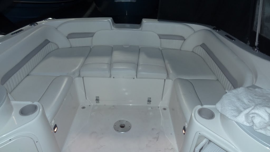

The cockpit...
Helm

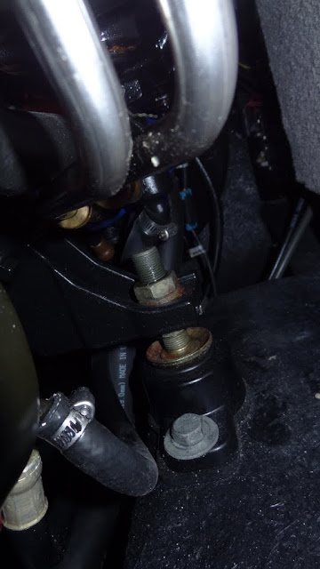

Motor mount..
details

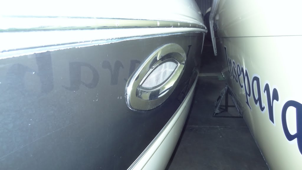

oudside hull numbers whited out in case any of the boat owners don't like that.

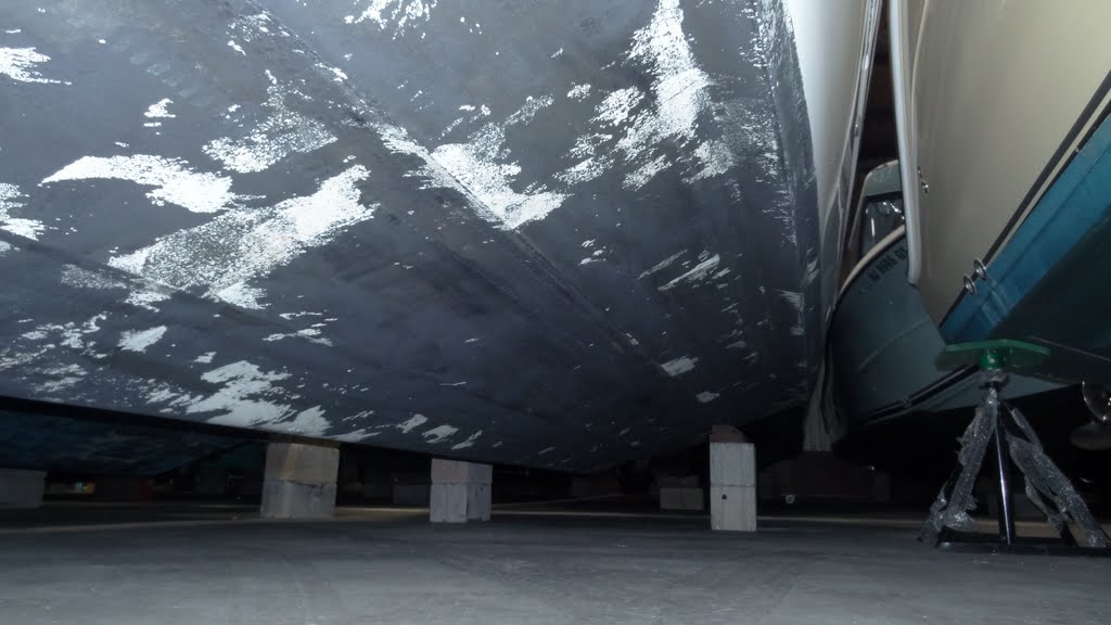

one of the hull shots..

Start with the oil. Timing case cover seal or the oil pan gasket. The thing is (Looks to be a mercruiser Chevy engine). If you can get the seal out after removing the damper without having to undo the cover great and add a new seal. If you have to remove the timing gear cover it has a 1 piece oil pan gasket and super hard to get the original gasket to go into the cover without A) undoing the oil pan engine lifting it 1 inch is required B) cutting the original gasket and using the old style piece gasket that is hard to get to seal. Make the best choice and take any measure nessecary to remove just the damper seal and put a new one in. Otherwise your gonna be adding oil and the bilge will keep collecting it and your gonna keep cleaning it up. Not environmentally freindly when the bilge pump pumps the contaminated water out of the bilge. Mildew is not a big deal little peroxide and water (Test on a small area. or good cleaner will do. Like bleach peroxide kills mold. That is what you want to cleean them wet areas with as well with a very good clean water rinse.

Could that be some RV coolant? Looks pinkish and the proximity to the water distribution housing drain suggests some may have been drained during winterizing. Also, I think I see pink crystals on the drain petcock. Coolant is slick to the touch like oil.

As for the mold, they sell kits where you swab the area to see if the issue is just ordinary mildew or some bad mold that may make you sick. Not saying don't buy the boat, but you can make the seller mitigate the mold condition as part of the terms of sale.

As for instrument lighting, tricky one there. Older cars/boats used bulbs, maybe not easy to find but you can always get them. Newer buttons use surface mount LED's that are not replaceable, in that case, you may need to find out from the boat manufacturer if they still stock them. Moisture in the instrument bezzles is a tough one, how did they get in, they should be sealed from water. You may have to take the instrument cluster out and dry out manually and then use some silicone to make sure it's watertight before they go back in. I had a 30 year old boat with instruments on the flying bridge that were always exposed to weather and waves at times and mine were dry.

You might be on the money. There was pink splatter in the sink as well so the antifreeze used to winterize it was indeed pink. Only got to touch a film on the bottom of my shoe, as it was too tight for me to squat down and too deep to reach from the deck, but it was indeed slick and did feel thinner than oil. I assumed there was water on the bottom of my shoe, but what you suggest makes perfect sense.

Thanks for the info on the instruments. That's the item that bugged me the most. There was a bag with several wet wet life vests in the storage area under the helm and it's been stored with that door closed in a warm warehouse since before hurricane sandy. I'm assuming the moisture buildup in that compartment traveled into the gages. If they're sealed gages, then I'm not sure why they got fogged. Searching the forums came up with several others who've experienced the same thing. Wonder if the lower priced boats also have less substantial gages.
