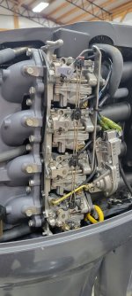

also running too rich or too cold will cause fuel to get in oil, because not all fuel is being burned in the cylinders it leaks by the rings.
rea dup on motors making oil and what causes it
I mentioned this prime start system to you in one of your other threads you started on this motor problem.
does your motor have a choke to help starting cold?
read up on what those 2 devices are on #1 & #3 carb are, and how they work
So what else could cause it to run too rich or too cold?

I don't have a prime cold start system. At least I don't think so I'm not even really sure what that is. It's a 2003 bass boat with a 50 hp motor
As far as I know I just push the key in and that's supposed to be the choke according to the previous owner
with the cowling off, listen and visually check to see if anything happens when you push the key in.
may be those 2 devices on the carbs 1& 3 operate when pushing the key, but that is not the way the prime start works on my C40 2 stroke.
just because you can push the key switch in does not mean it does something, but you can verify easy enough
I had a 35 Evinrude that squirted fuel into the carb when I pushed the key switch, but it also had a lever I could push on the carb if the electric part did not work

Want to know what I was just thinking? Another thing that could be flooding my oil with fuel is possibly a stuck float. Does that sound correct?
99yam40
Sep 7, 2008
9,295
that would not cause all cylinders to fowl their spark plugs, only the one with the stuck float
you may need to remove the silencer from the front of the carbs to see if there is fuel dumping into the motor due to a stuck float in one or more of the carbs

Are you talking about that big ass long plate that attaches to all of them?
99yam40
Sep 7, 2008
9,295
it is just a plastic cover, that helps keep the noise down.
you cannot see into the carb throats when it is in place
