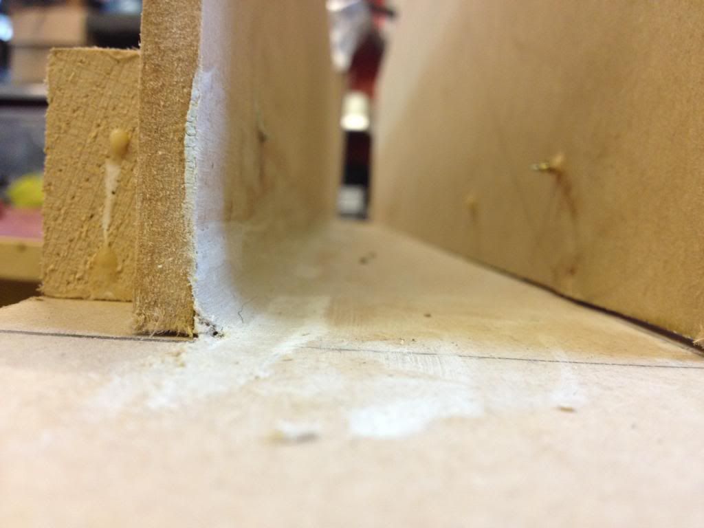

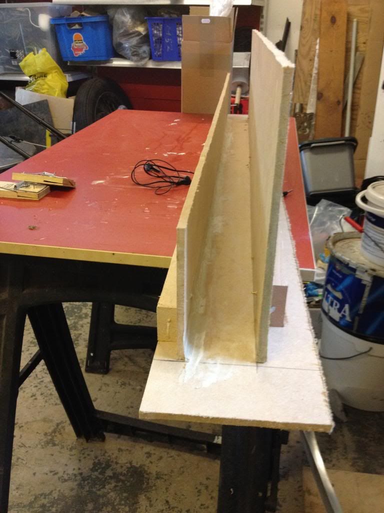

right little bit of an more done this morning got the mould made for the front of the well. was a pretty simple thing to make tried using body filler to make the curves but wasnt very easy to do. i have heard of using plastasine to make the curves but don't have any here so means a trip to town. Do you guys have any ideas on what to use?

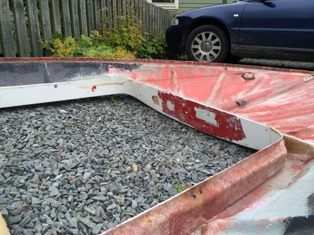

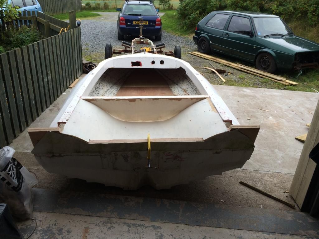

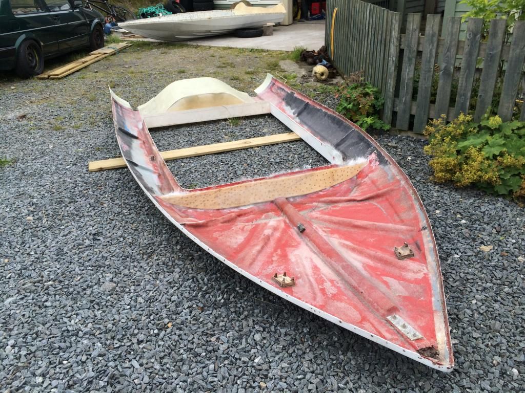

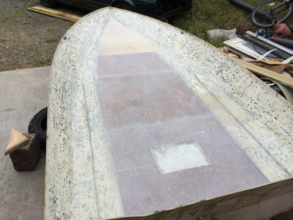

Progress has finally been made on this after nearly a year of it sitting upside down in the field i took it down to the garage this week and got stuck back into it. I got the two sections of the well that i popped out of the moulds last year from the loft and fitted them to the cap and lightly glassed them in for now until i get the final end pieces made. The fit was pretty good for my first set of moulds i had ever made.
I also got the front bit of deck cut out so have managed to get both sections joined together, sealed on the bottom side and glassed in
Ive also got the dash panel replaced and made a start glassing that in place and filled all the old holes in the dash as well as the bits that had been butchered out of it for the old morse controls.
