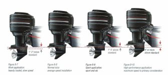

Or a bad impeller. Check your impeller if you haven't in a while. As for your prop. Look at the recommended WOT rpm for your motor and if your'e in that general area, it is not your prop, which wouldnt really cause it to overheat, but more of a over speed. Check where your outdrive is in the water also. Heres a handy diagram. Im not sure about a pontoon. Its gonna depend if its a tritoon or a regular two tube pontoon, where the outdrive sits. Good luck.

Also, all boats have a recommendation for HP. Is the outboard the same size as the previous one, or at least close?
