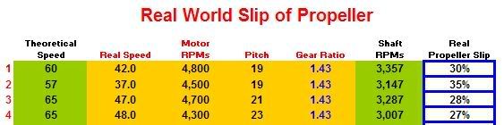

Nate, it appears something is wrong, but there are a few things that ould ause your prop slip to be this high.
My ?c? is not working right now so please bear with me until my new keyboard gets here.
Prop Slip
1. I have the wrong gear ratio, please hek this
2. Your tahometer is not working orretly
3. You really have this muh prop slip
We just need to know whih one of the above problems we have to get a better prop for your boat.

Ram, if the gear ratio is even 1.6 his prop slip is still 27% at WOT. But isn't that SX a very different hull form than his Horizon. But if what I think is the problem then we definitely need a 4 blade stern lifter, I am just not sure whih pith yet.
WE need to take the boat out with a hand held tahometer and verify the RPM.

Alright sorry about the bad info all the research i did suggested that the 1:43:1 gear ratio was correct i should have just done the test in the first place i was going out to do the test and i saw on the leg it says gear ratio 1.79 so that would be the ratio. Here are the specs on my props
Aluminum 14.5 X 19 not sure of the brand heres the number on the prop3850301
Aluminum 14.25 X 21 not sure of the brand heres the number on the prop3850302
Stainless 14.25 X 23 Turning Point Express
So The owner that had the boat before me said that he could get GPS 55mph out of the boat with the stainless 23 and i can only get 48 so theres a few options
A) the boat needs a tune up
B) he was lying
C) the 21.5" wide whale tail is affecting my top end
D) he was at sea level and i am well above it
As for the tach i am pretty sure its dead on because it hits rev limiter at about 4900 which is the factory rev limiter on this boat
Hope we can get to the bottom of this because i think that a 5.7 in a 18.5' boat should be able to do over 50 no matter what

LOL Nate, I am working on it. Whale tail is a nono for a boat like yours and elevation an maket ons of differene.
H
hwsiii
Jan 25, 2009
2,639
Re: Prop Issues
Trim tabs are perfet but whale tails an atually slow a boa down when you trim the motor up as it rates a lot of drag on some boats depending partially on how muh the motor trims up. I ould go into the problems of tripping but just know you an lose up to 5 MPH.
I need to know what elevation you are running the boat at beause that an make big differene as well.
H

According to Google the elevation of where i live is 1993Ft which is where i do most of my boating

Nate I need to think about your prop overnite. Your answers to number 18 are usually mutually exlusive of eah other TOP SPEED and low PLANING SPEED.
H
fourwinnsnate
Petty Officer 3rd Class
Jul 16, 2009
76
Re: Prop Issues
Yah i doubt that i will be able to get both out of one prop i have no problems running two props i just want to be able to plane at a low speed with one and i want to be able to do 55mph if i want to but my trim tabs came in so this weekend i will put them on and try the stainless 23 for top end
hwsiii
Jan 25, 2009
2,639
Re: Prop Issues
With those two hanges I expet you to get right next to your 55 MPH.
H
fourwinnsnate
Jul 16, 2009
76
Re: Prop Issues
Alright so this is a good cruising prop but i doubt i will be able to wakeboard with it even with the trim tabs.
So what is a good wakeboarding prop? I was thinking somewhere along the lines of a four blade 19 or 21
