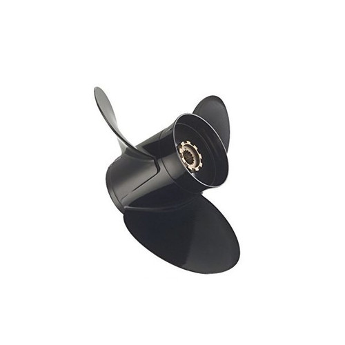

@Scott Danforth What prop brand/model did you run on your 15P 3 blade? All I can seem to find in a 14-1/2" diameter 15P 3 blade (and 4-3/4" gearcase) are some older Vengeance/Silverado SS props. I was hoping to find some aluminum props (due to lower cost, but also making the prop the sacrificial component on debris strikes) in this dimension, but can't seem to locate. Separately, I decided to order the reasonably priced 14-1/2" 19P 3 blade Black Diamond that I linked on post #27; which I'm guessing will be my "unloaded/high speed prop".
michigan vortex has them in 15"
here is a merc black max
So these two props are 15-1/4" diameter. Does 15-1/4" fit an Alpha 1 (to clear the cavitation plate that is)? If it does fit, would that diameter perhaps be too large for the 3.0L to turn efficiently?

Yes it will fit an alpha. Actually the Enertia ECO will even fit an alpha with a 16" diameter, hardly no room to spare but will fit. Not recommending it just making an analogy

yes usually as you go down in pitch diameter tends to go up. None of these aluminum props are going to have so much bite that they will not turn, worry about that when you go with the higher end SS props.
check out mercs prop selector will make some general recommendations
