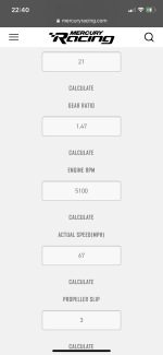

Hi. I use the Mercury calculator
You’ll need;
Speed at full throttle in gps
Rpm at full throttle
Gear ratio
Current prop pitch
A real performance hull with power can achieve 2-4% slip, well propped. Average to aim for would be 7-10% generally. Picture of mine below
