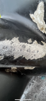

Okay, I found the number it's 48 73138 A40 14P

That looks like a Rubber Hub Prop, and the Face of the Prop where the Thrust Washer goes isn't worn away from a Slipping Hub\
Can you provide a couple Pics of the Prop on the Engine, One from the Side, and the other also at that height, but at a 45 Degree Angle looking toward the rear of the Gearcase, from behind.
I ask this cause I think the 10X14 is for a Lower HP engine that uses a Smaller Prop, and the Hub of that prop is too small to Funnel all the Exhaust Gases thru, it and some are going out over the Blades, resulting in Ventilation
