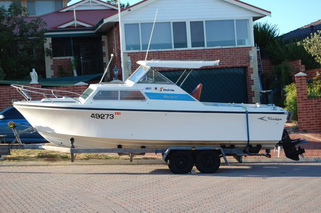

Have a propellor on my boat (Savage Bluefin) that has the following indentification numbers;
48-66456A4 17P (itch)
Cannot find this proppellor in my catalogue, sadly
I would like to know which SS propellor to purchase.
Propellor on boat is old and has seen better days.
Plus the boat could do with a bigger prop as it jumps to max speed @ 4000rpm (27knots)
boat is 2.5ton, 21 feet, fibreglass cabin cruiser
also have a spare prop 48-79576A4 21P, could this be used?
Comes up in my Michacan wheel catalogue as an 13 3/4 Dia -21"P
Your help is much apreciated.

Specifications of "barge"
Long= 6.4mtr
Max Beam=2.44mtr
Deadrise =22 degrees
Hull weight=966KG
Weight on trailer=2300KG.
min Planing speed = +/-13knts.@2300rmp.
Is in top 10 of most wanted Australian Trailer boats in multiple publications here Down Under due to it's seaworthyness and build quality.
As I have the other propellor already for my IL6 2 stroke "tower of Power" smoker,
I will put other prop on and try it out if it fits and how it goes.
