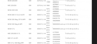

There are two oil quantity specs for these engines. It’s in the manuals
QBhoy
Mar 10, 2016
8,348
Thanks for that QBhoy. What manual is that out of?
It’s off the internet to be honest. I looked at the Manual for my engine and it suggested over 5 quarts to be honest. But it’s Defo not. Then I remembered that there was revised info on it since.
