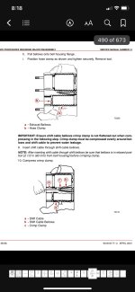

Manual 14 pg 4B-66 says to crimp shift bellows (zip tie is fine too) -
it gives a spec for clamp to be 2.5" off the bellhousing.
