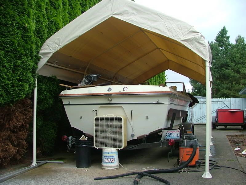

I'd get an 'over' cover to keep a layer of air between the boat and it's cover. I tried to find a link to show you what I mean but could not. Ah, I just figured it out. I will post a pic of my boat. I got this 'over' cover from Costco for 169.00 US. You probably do not have Costcos in the UK, but this is what will keep your boat from sweating and forestall the need for you to prematurely have to coat the inside of the boat with anything. I live in the wet (9 mo's out of the year) Pacific Northwest USA and this was the very best thing I could have stored my boat under except for indoors.
I may have misunderstood your requirement. I thought you were just trying to protect the inside of the boat from the coming wet winter.

I wouldn't use any coating to temporarily protect your boat from sweat moisture. The tighter you cover the more sweat you will encounter.
Can you hook up any kind of timed fan and ducting to ventilate the inside of the boat? Before I had my over-cover, my canvas cover had air vents at the top of it. I used to hook up a fan, inside the boat, on a timer and let it run thru the morning hours when the dew point was most likely to cause condensation. It worked very well.
