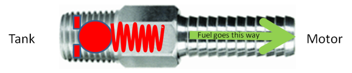

Depending on access it could be better or worst. Your fuel pump is under the port side of the motor and behind the motor mount. Its in a black plastic box.
The antisiphon valve which connects directly to the fuel tank and has a barbed end which the rubber fuel line connects to. It's a spring loaded valve and if sticking can also cause the issue. So if pressure is up to 30 and stays there until high rpms on the water, the valve could be the issue

The anti-siphon valve (a ball bearing in a sleeve) was all gunked up. I couldn't blow in it regardless of direction. I replaced that and also added a primer bulb inline to the fuel filter so I can see if there is suction in the fuel line (also helps prime the new fuel filter :) ).
