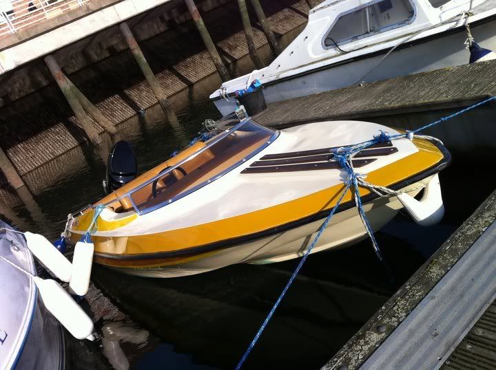

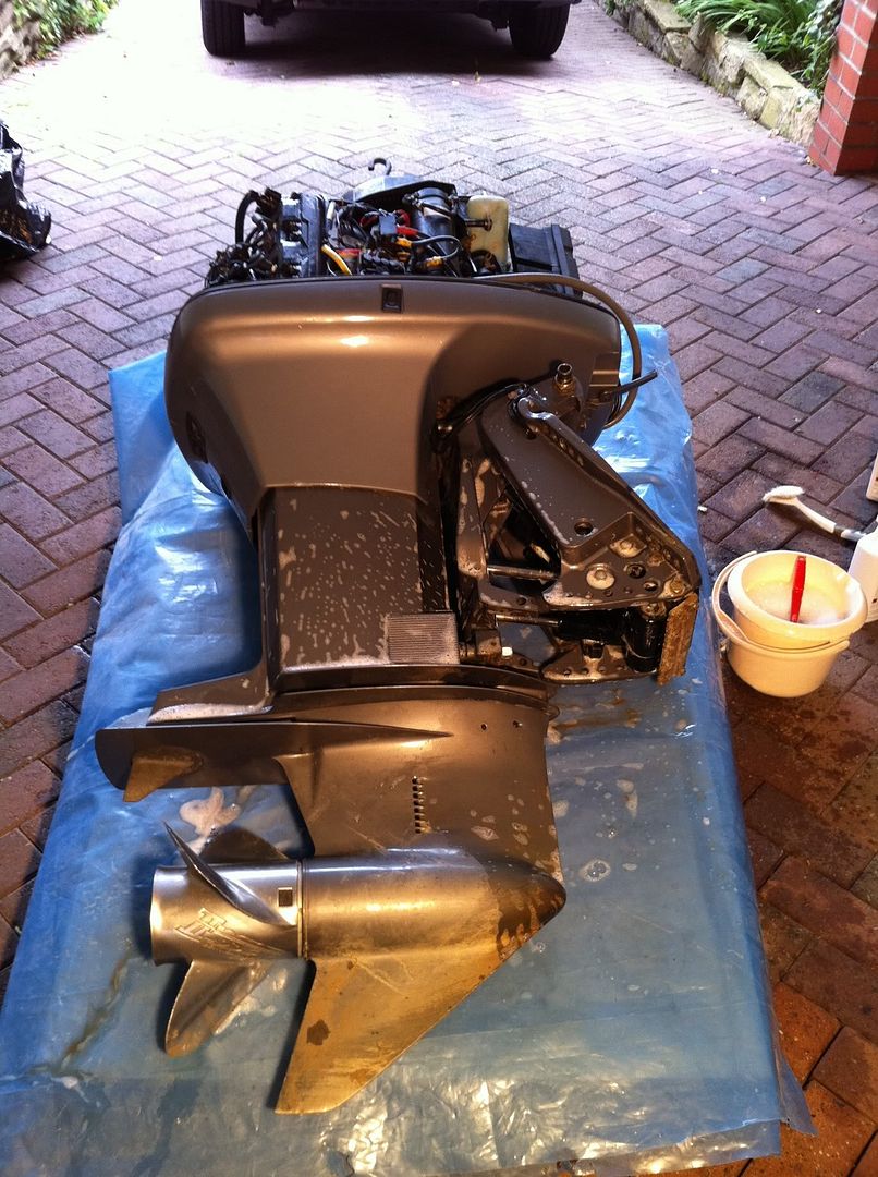

Well I took the plunge and bought a 1998 Mariner 135. The thing is in very very good condition and came at a decent price.
Here are a couple of pics (although I'm sure you all know what these look like already :p):
Just need to buy a new decal set (ouch ?$? :eek:) and it will be like new.

Nice looking boat and good decision on the engine. I've owned several this size that have been powered by 115 to 135 hp motors and think even 150 hp is pushing it. These boats are so light they don't need much (and there is always that pesky liability issue with the big motor).
Now if you had asked when I was much younger, I'd have asked "is 200hp really enough????"
