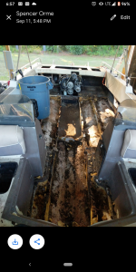

Thanks! A good deal of what I've learned is from boatworkstoday's YouTube page. He's a great teacher and he is ultimately why I decided to go with poly. He does a few comparison videos you may be interested in watching. Showed that chop strand and other mats are help together with styrene and poly has styrene in it and it breaks down that styrene and absorbs really good into the mat. Layup was a noticeable difference. I really wanted to use epoxy until I saw that, the price, and another strength test video he did. I'm definitely elbow deep at the moment! Pic attached

you will need to pull the cap and the drive/engine prior to cutting into the floor
I have seen his video's
He does very respectable work, and informative too.
Lectro88
Oct 24, 2020
303
I looked at your pic and chuckled under my breath.. About all the several 100's of projects that I have seen, seem to almost have the same look.. including both of mine.

I'm avoiding pulling the cap off at all costs, being it's huge and it's my first big project, but the motor and drive are coming out and I'll be redoing the bulkheads and transom. I do have a backhoe I can rig to pull the cap if necessary. The guy I mentioned that owned the boat store told me about that woodless stringer idea. He used to build boats. Said you can use wood to form your stringers, coat them in floor wax, glass them over, then pop the glass off once it's cured. Then fill with foam after you glass them in. It is a tempting idea. However it goes it'll be right when it's done. I'm very peculiar about the things I do, probably to a fault for most people. And I really love this boat so I'm gonna be picky!
52,760
You can use your garage rafters and ratchet straps to pull a cap
Dquinn
Feb 13, 2021
20
I did consider rigging up in the rafters. If it comes to that I might do that. I only have one open bay do hopefully I could get it high enough to secure it and work underneath it.
