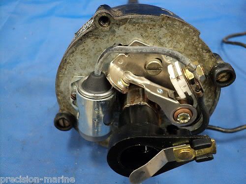

Here is a photo of a distributor that I picked off of the net. In this photo one can see the black cupped washers that I initially asked about in this thread.
Also note that the points shown in this photo are different than the ones that I have. The adjusting slot appears to line up and the wires are attached with a threaded part and a nut whereas the ones that I have just require one to slip the terminal in behind the spring.

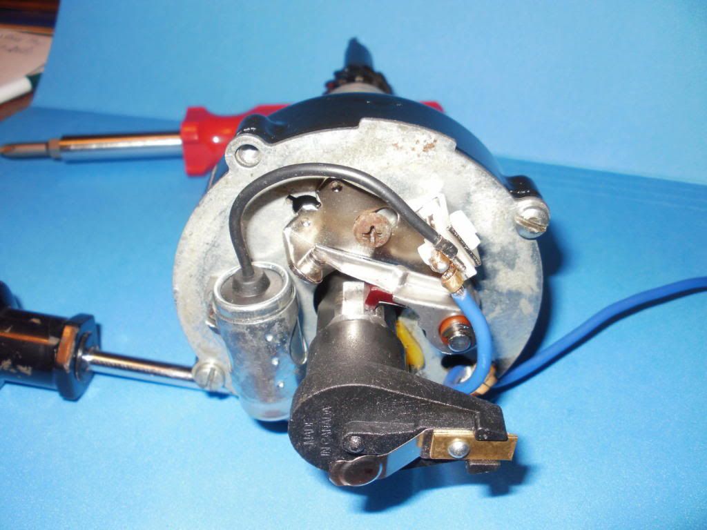

This one is my distributor. Note the awl and the screwdriver are just there to keep the distributor propped up for the photo.
In this one you can see that the points are a bit different and the lack of the cupped washers. As I said at the outset I can see no purpose apart from locating the cap but I am open to opinions. The tab at the top of the photo fits into an indent in the cap and it seems fairly solid with little movement even before the screws are tightened down.
