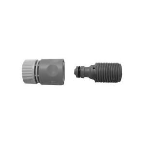

Chris,
Sorry it took so long for a response. I ended up taking off the fitting and looking down it but there was nothing there that would clog it. I did notice that the valve was rough and sticking. I ended up replacing it and all is good now.
Here's a pic of what it was doing but it's all good now.
Thanks again for all the guidance.
