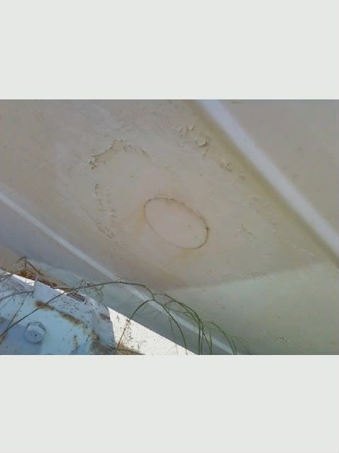

There is also these bilge drain looking things on the hull and I am wondering if this is bad or good or fixable (I know everythings fixable with enough money thrown at it).This is the port side

Well, the Above the waterline pics show Normal to be expected Spider webbing cracking in the Gelcoat. Not a hard fix. Something you could do realtively easy. The pic of the hull is a bit more concerning. The circlular area... Not sure what that is showing. Think a closer pic will be required to sort that out.

The circular area on the starboard side has that grommet looking thing I don't know what it is. The port side is in the exact same spot but it looks like they removed the grommet and filled it in. I don't know what it was originally for nor why they decided to fill it in.

Hey yabuoy,
The starboard side has a thur hull spout in it. Looks like it may have been a drain for a live well.
The other side looks like a bad patch job to me.
Is there anything in the boat over the holes?

The cracks in the raised area of the deck look like they're from thick gel coat. On the mold this would be a low spot and somewhat more difficult to spray, so having gel coat puddle there wouldn't be uncommon. They are a cosmetic issue that can be fixed with a little work.
The paint or gel coat needs to be removed from the repaired spot on the hull so you can see if it was done correctly, correctly means its thick enough and still sticking to the hull. Also, can you see these from the inside and post a pic.

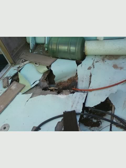

Floor damage (already wanted to gut a project anyways tho)

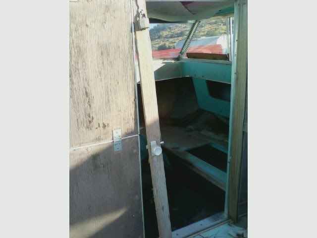

Cuddy view:

Well, From what I can see There's a LOT of work there, but like you said before, Everything is doable, but I'm seeing some $ signs.;)
