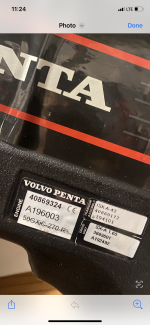

My boat info
40869324
A196003
50gxic270r
I appreciate your help
