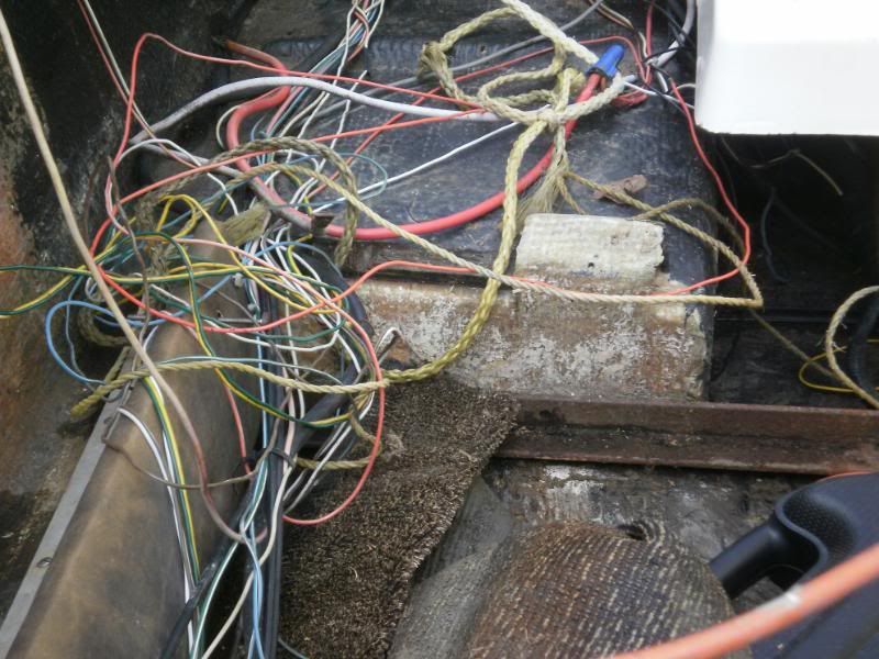

The boat has no power. The wiring, in fact, is a bloody mess.
The hydraulic lines have also been fudged.

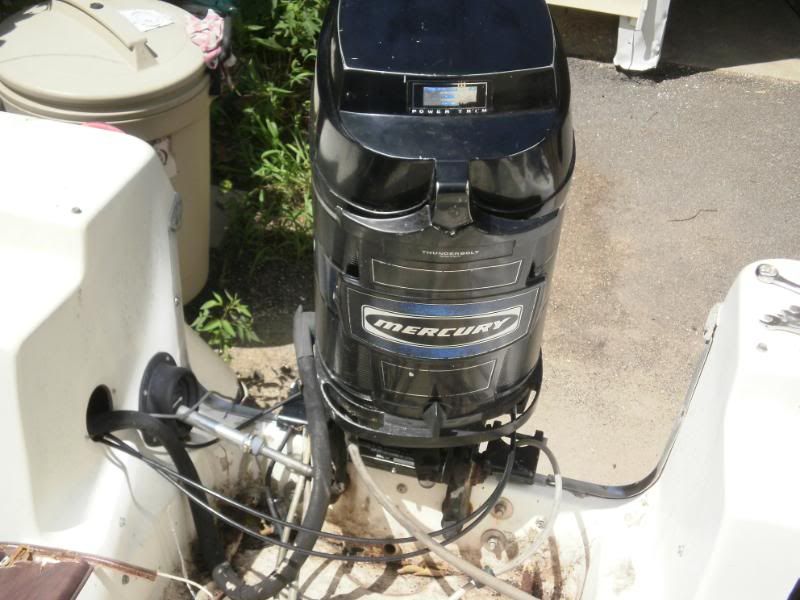

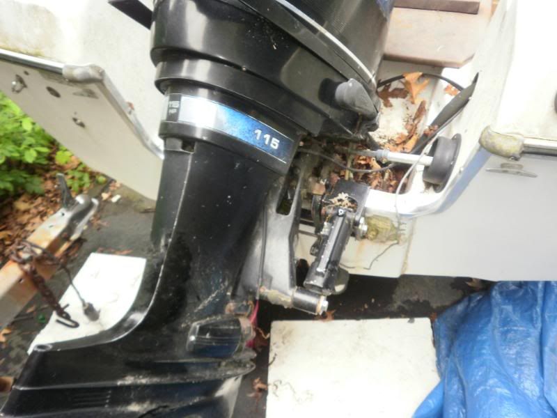

Had another thread going on this motor trim problem. Can't find it, but I finally got the motor lowered. Wound up bleeding - the starboard side, at least. Nuts were stripped on the port side, so I cut the line. Line was dry as a bone, but motor is lowered. Hope to get it off tomorrow.

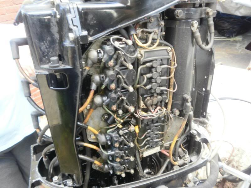

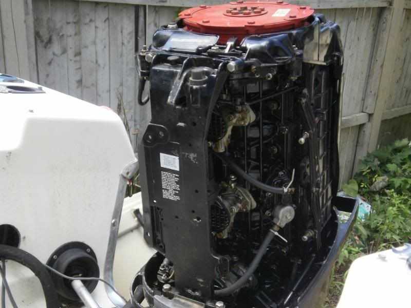

Motor looks like it's in pretty good shape:
Flywheel is very stiff, but it turns. Grudgingly.
Typical of the sort of maintenance done through the years - plastic ties holding the fuel lines on:

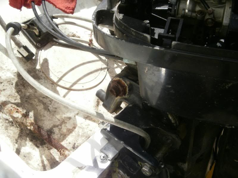

Few more photos from the 26th:

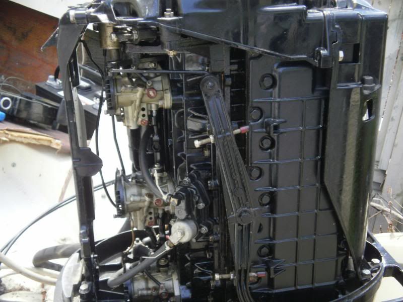

This bolt needs replacing:

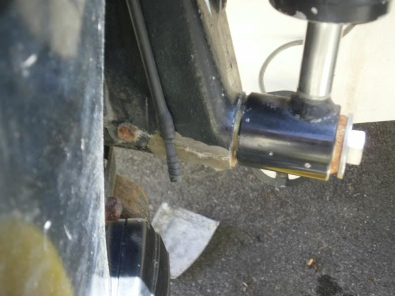

I'm a bit concerned about this crack, and the goobered patch on it:

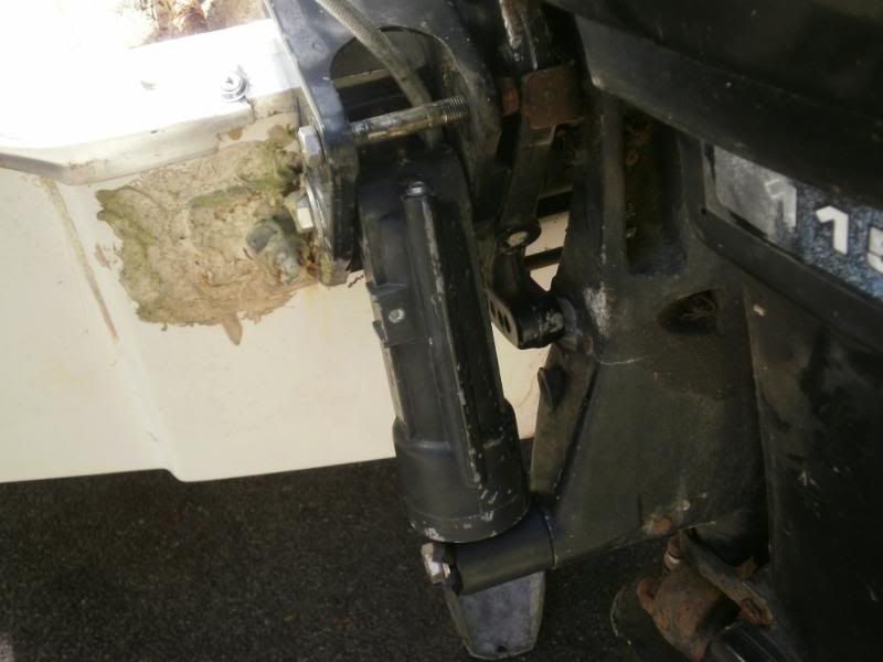

Had to cut the line to this, then remove the bolt to let it drop with the motor:
