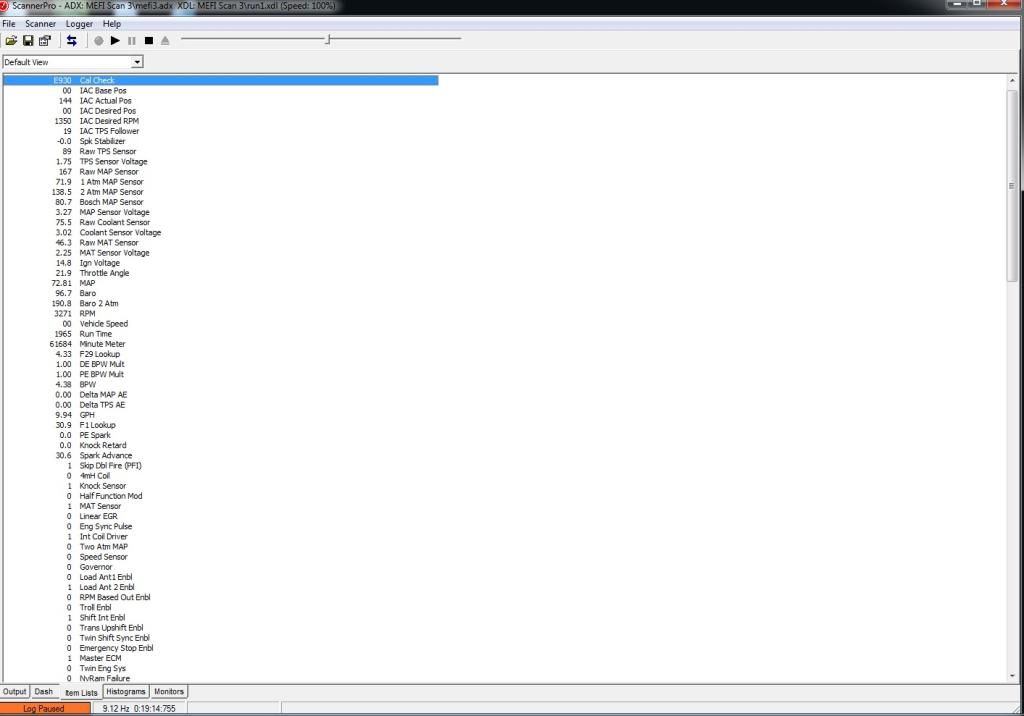

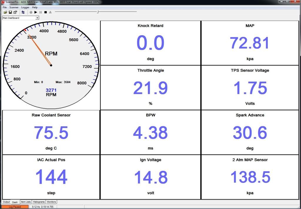

Under full load at 3000'ish RPMs the ECU is commanding 30deg spark advance, is this normal? I could not find the timing curve chart - maybe I overlooked it, I'm using manual #24.
I still need to put my timing light on it while operating it to see my actual max spark advance. I'll get that next run. I have a MEFI 3 ECU installed. I'm also running hyper pistons which actually recommend to decrease timing by - 2 degrees - if I understand correctly that means set base timing @ 6 deg instead of 8 deg.

Part of what I see is your Map is screwy. That can mean you have a bad map, or you might have a non-sealing intake valve, or something else. But it probably just a map issue both your innie and your outie are no good.
At 3k rpms your map is reading 73 kpa, which is about 10psi, which is way to high for an engine turning that many rpms, you should be closer to 5 or 6 psi.
I'm not familiar with your software, but I'm assuming on the bottom right where it says atm map sensor that it means Atmospheric. It's reading 138 KPA, which is roughly 20 psi. . That's a good reading in you live on Venus. But here on earth atmospheric pressure is 14.6 psi at sea level on your average day. If your ECM thinks atmo is 20 psi it will never run correctly. That needs a looking at, and your fuel pressure should be cranked up to 40-45 psi for something like this.
As long as your software is accurate, and you can plumb in a basic vacuum gauge to double check it. Your Map is off 5 to 6 psi on both the maniolds pressure measurement, and also the atmosphereic measurement.

Thanks for helping me understand my data. I only have one map sensor and I do not have any o2 sensors. I believe that call that an open loop system? (Correct me if I'm wrong!) I do not understand how I could have two map readings if only one map sensor! Unless both are built into one. I'll change my map again to see if that changes my data. I also have another mefi 3 ECU, I'll swap that around and see if that changes things. All in all she's running very well (to me that is!), but I was thrown by the data as well! Didn't understand how my map could be so high, then again you don't know, what you don't know.
Sorry for the late reply I have been very busy with work! Time to get back on the boat. I'll plumb a vacuum gauge and check it out. I had my intake cut/hot tanked at the machine shop to correct for any warpage, also new 906 heads with stainless valves - 3 angle grind - but maybe I do have a vacuum leak - I also did not use the cheap plastic intake gaskets, I used the heavy duty ones from fel pro the 9800 I believe - metal imbedded with rubber.
I did change out my map sensor with automotive - I should use/check another map to make sure I didn't shoot myself in the foot. ( I have the little square one - not the large rectangular one ) Thanks for the information gentlemen! And also for the input! I'll try these suggestions and post another data log. If you guys have scanner pro I could email you my data log of my run, you can play it back and see what's happening.
