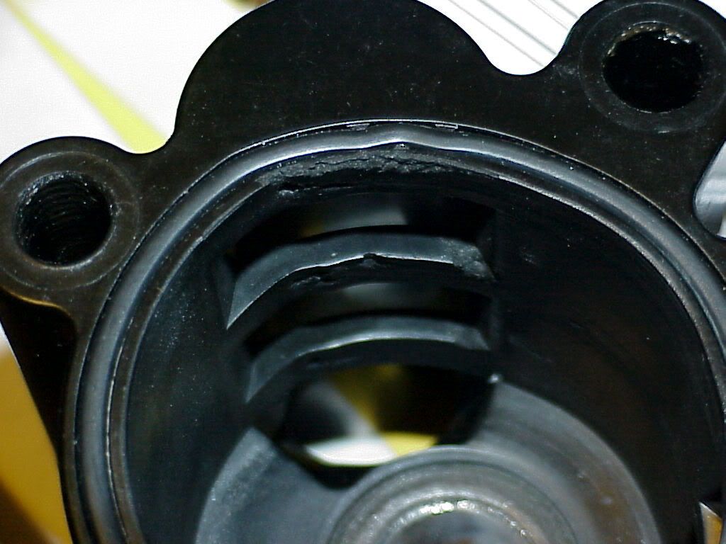

Re: Raw water pump impellor problems!
Nope, never heard of them failing after just 20 hours of normal use. Shoot, mine lasted 3 years and 400 hours! The black plastic pump housing has the same rib you speak of:
