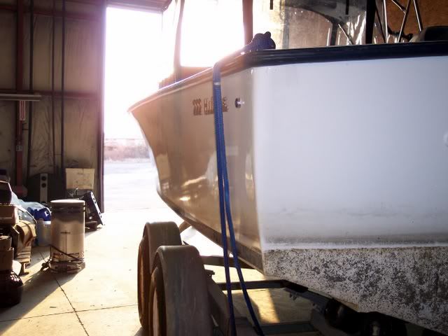

Thanks for more info, I have some decisions to make for sure. I haven't taken any pictures in awhile but these are the day I brought it home and after the floor had been replaced. Since then I have built the entire interior, had all pieces reupholstered, and put in new carpet. The engine is in and the interior is now out and I have cut a hole in the floor and installed a hatch with tub in the bow passenger compartment. I put a drain line to the bilge and am gonna try this for a small ice chest and if not it will just be another storage compartment. I'll put more up to date pics later today. Hoping to get it painted in the next week or two and be on the water by spring.
