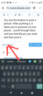

You use this button to post a picture. After pushing it, it takes you to pictures on your phone....scroll through them until you find the pic you want and then post it.
