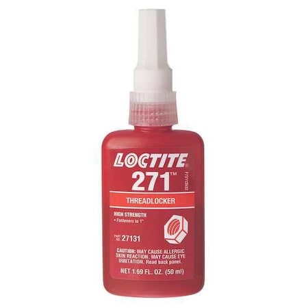

As far as loctite goes, you want the 271.
Threadlocker 271, 50mL Bottle, Red
Look close at the bottle and below the 271, it is labeled as 27131.
Not sure on the 3M.
