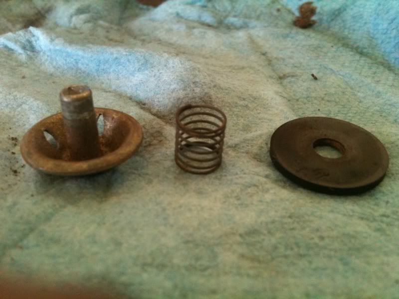

rebuild mech. fuel pump on mercruiser 470.. works?

Re: rebuild mech. fuel pump on mercruiser 470.. works?
Yeah I thought about going with the electric pump... I figured it would cost more by the time I bought the pump and the oil pressure switch, but looks like I was wrong. The only thing I can see good about it over the mechanical pump is I think it would get fuel to the carb faster after sitting for several days. Might could even wire up a "prime" button at the helm to run the pump for a couple seconds prior to cold starting to help gets fuel in the lines and the carb before trying to start. Anything wrong with that idea?
Anyways.. So I just took the pump apart again.. finally got the bottom part of the pump apart, was careful to not tear the gasket since I didn't get a new one with my kit. I took the checkvalves out and they seem to be in good shape. I'm not sure if they were stuck or not, but I sure cleaned them up good and they seem to seal pretty good and don't get stuck. I included a pic for any opinions. I'll be putting it back together here shortly.
Got it back on the motor... I kinda rigged up the elec pump on the IN side of the mech pump to prime it up, then removed the elec pump and turned over the motor a few times and it seemed to be moving fuel out of the pump, so I think it may be working now. I think maybe the checkvalves were stuck. Can't really tell for sure if it is working right yet because it seems either my starter needs to be rebuilt or the battery is no good (could only turn it over a few times before it pooped on me). One problem after another! Isn't that how it goes...
Thanks for all the help guys.. Maybe this will help other people doing the same thing.
