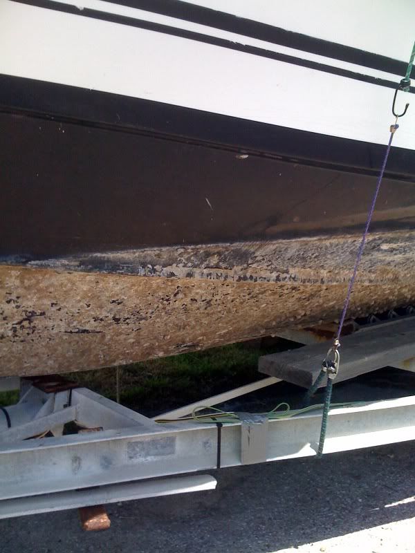

Here are a couple pics of the boat on the trailer:
I know these pics are a little rough, but hopefully this will clarify things.

That trailer looks WAY to short for that boat. Also, what is the trailer rated for and how much does the boat weigh?

Re: Rebuilding my trailer - need help!
In that pic, the boat is not fully on the trailer. I currently have the boat pulled all the way up on the trailer and it looks much better.
The back of your boat needs to be pretty much even with the back of the trailer. Is it?
Is it just me or do those tires seem awfully far apart. How does that trailer like going around corners? Much tire scrubbing?

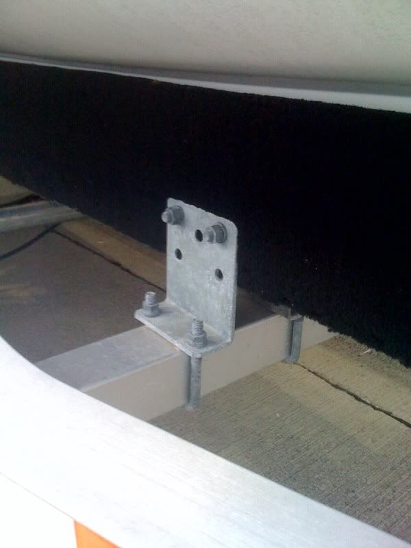

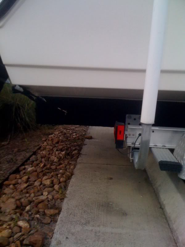

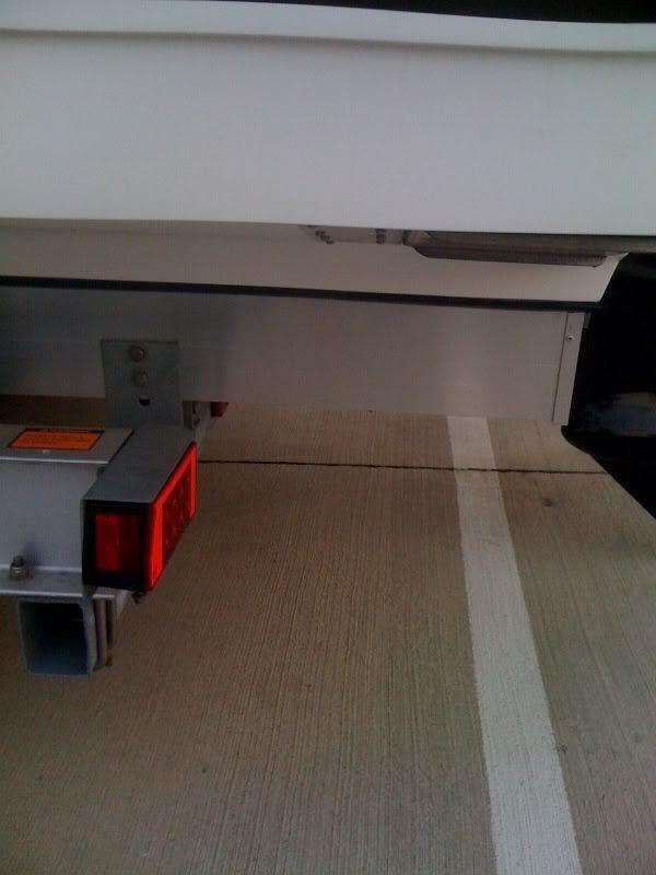

Well, Ive been browsing around my local boat dealer just trying to get ideas on how to rebuild this trailer and I've found that most boats similar to mine in size and shape, hang off the back of the trailer about 1 1/2 ft. or so. However, the bunks run past the back end of the trailer to fully support the boat. This is why I have decided to construct my trailer the same way.
Here are a couple pics of a brand new 24' Mako and its position on the trailer. Directly from the factory, no modifications.
Here is a pic of how I plan to attach the bunks to the frame of my trailer:
I agree that the tires do seem far apart. I am going to completely replace the suspension and the wheel hubs. I am going to go with hubs that have a different bolt pattern so I can mount larger rims and tires on the trailer. This should bring the wheels closer together and make for a smoother and safer tow.
bruceb58
Mar 5, 2006
30,796
Ok..as long as you put the bunk lumber on end like that and it is similar to the pics you show, that should work. Just make sure that you have the proper tounge weight when you are done.
