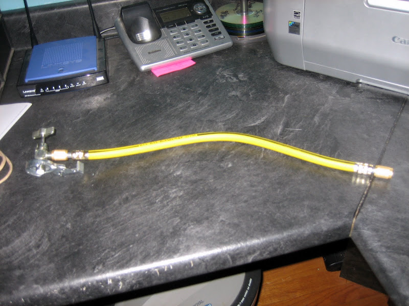

Anyway, I track down the right hose setup on ebay, which clamps onto the top of the can and then has a needle to pierce the top (notice the hose is yellow...apparently that's important.):

You locate the ports. One is high pressure and should run a little over 200 lbs and one is low pressure and should ideally be around 30 lbs. You locate the low pressure, screw in the yellow hose and open the valve. Then, you occasionally check the high pressure side for the aforementioned 200 lbs.
In my case the 200 lbs was really 100 lbs and the one can got it up to 150 lbs. The second can I bought suuuure would have been nice to have.
In the end, the truck produced relatively cold temperatures. 50s, maybe. 60s? I dunno. Colder than the 90s and 100s the windows have been producing lately.
